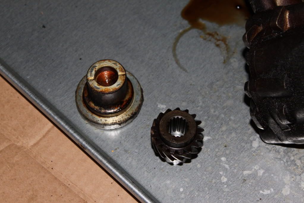

Also had a question about the oil pump gear. I pulled the old one out of the 16v block and placed it and the old oil pump to check for the piston rod hitting it. Pic below of said parts...
I'm not sure what it's called but the part on the right(plug for the old distributor hole) just appeared to be set in there without anything between it and the gear itself? It was like this when I pulled it from the old block. Almost seems like there should be something between the 2 otherwise the gear is just spinning against the plug?

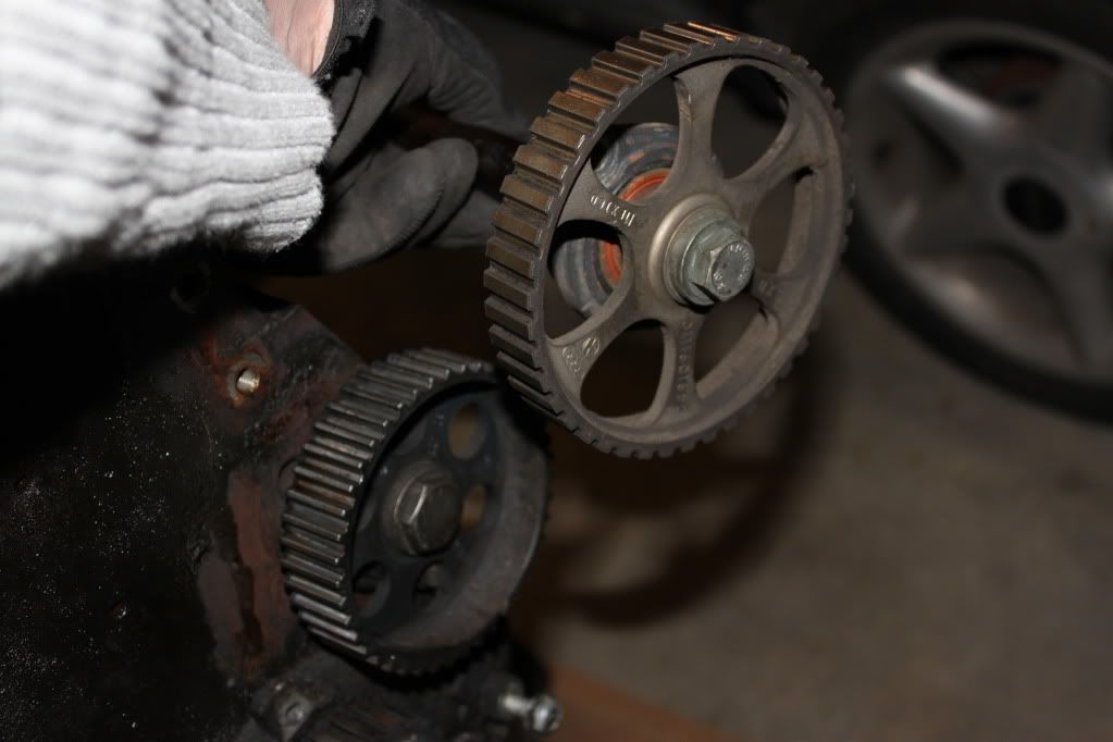

Also when I switched the intermediate shaft the sproket from the original ABA is considerably bigger than the 16v one? Is that alright?

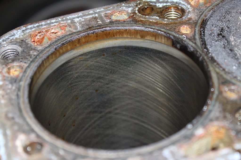

Here is a better pic of the cylinder wall after I wiped it out a little.

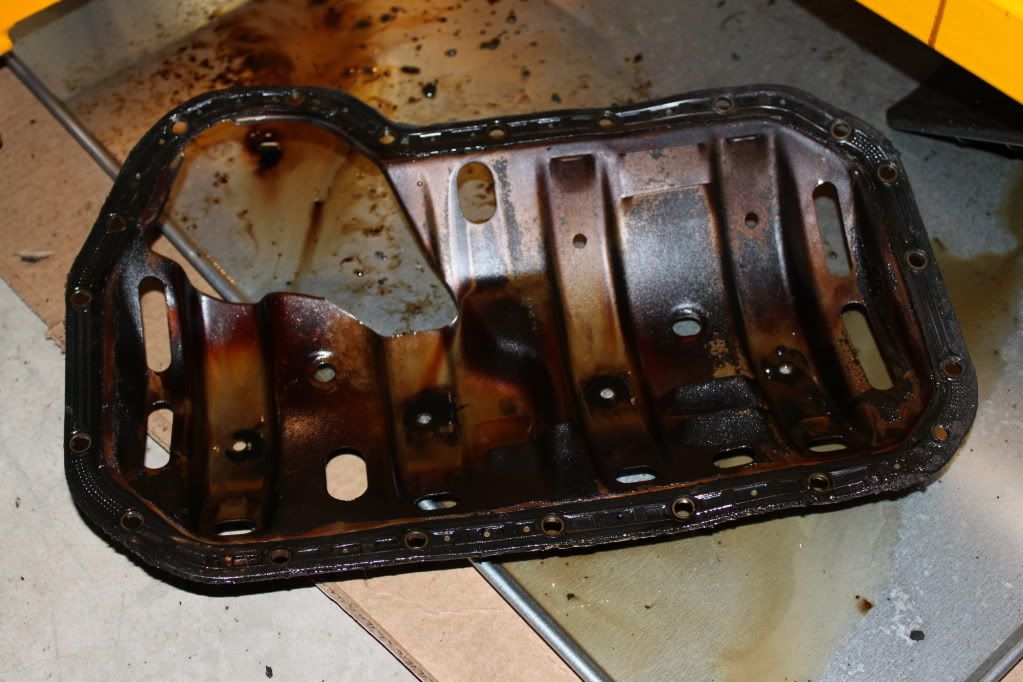

That damn windage tray that was giving me a fit removing the oil pan...

J, I have some input, and please excuse my ignorance because I don't know your experience with a motors/rebuilding (I am no expert by any means), although I do know you are a 4x4 guy and super smart.
IIRC the rule of thumb is that if the cylinder ridge can be felt with your fingernail it needs to be removed (or smoothed out at least). From your pics, that block looks worthy of a deglaze, which would bring back the cross hatching and reduce that ridge.
Since you are having your block tanked, have the shop deglaze the cylinders and check the tolerances on the cylinders, crank and rods. If everything checks out then you know what parts (bearing sizes etc.) you need (or need to recon or replace) and you have a fresh block that will have full compression after your refresh/rebuild.

If you can swing it in your budget, I would really suggest getting a deglaze at the minimum, and new rings. But I understand sometimes it's not a priority or in the budget to have all that machine work done.

ok sorry i forgot some steps, when it comes to oil pump brand, they are all aftermarket unless you get it from the dealer like i did, i dont see an issue going with GAP! never had or heard an issue with them. Keep the smaller pulley on the IM shaft, out of the 16v and into the ABA dont change anything with them, and also you will need to swap the 16v's toothed crank gear onto the aba, the 16V timing belt is much wider to handle twice the valvetrain. The oil pump gear plug, thats all that is there. youll have noticed the 16V one being too small to fit the hole, youll have to call TT tuning, they sell a 25 dollar adaptor ring normally designed to adapt a distributor. and thats all to put it together. As you see the scratches on the bolt.rod, youll see how little has to be removed. its really not much. looking good, glad to see some updates from your neck of the woods! you cant beat a hone and ring job, it does look good enough to roll with IMO

Oh awesome, it makes me feel better to know that the motor is a transplant. And you know the history of the car too - very cool. Well the block shouldn't need much, if anything really but I say since you have it out have them run the bottle brush. But, the shop should know what you need (or don't
. Good luck with it all and please keep posting updates.
