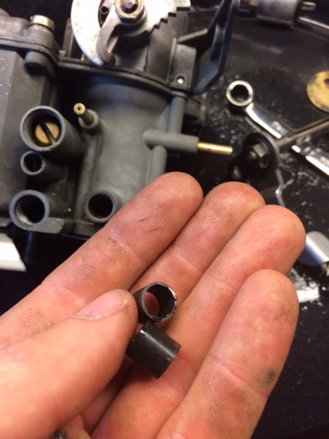

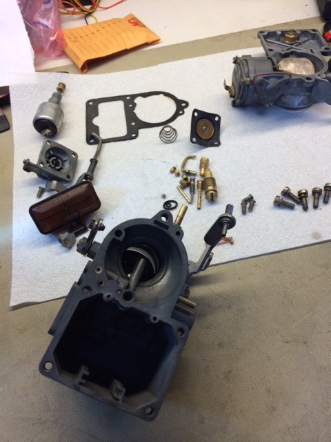

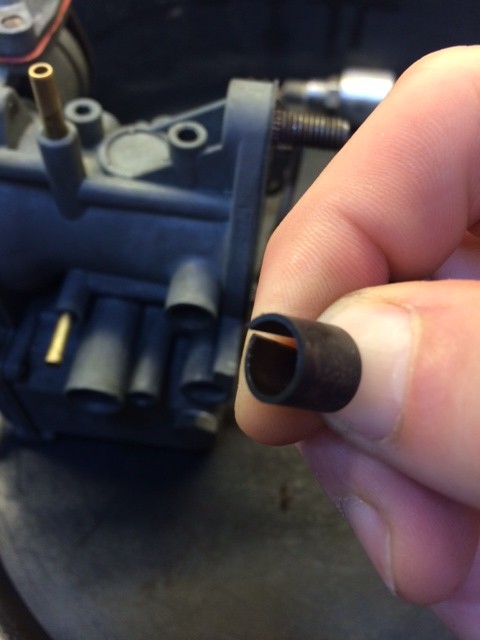

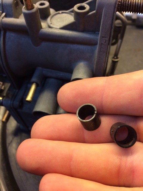

having removed, cleaned, tweaked, reinstalled, removed, cleaned, puttered, dinkered, fussed, removed, installed, tested, probed, prodded and cursed at this carb more than I care to admit I have found what I hope to be my problem.
If my guess is correct, cleaning the carb actually created the problem.
I have determined through the use of mapp gas that my throttle shafts are leaking air from both sides.
I'm thinking that cleaning the carb removed the built up varnish that was sealing these.
So yanked it AGAIN
pulled the shaft out and got the bushings out.
Searching the internet results in VERY few helpful results. Most say "send it off for a rebuild" or "buy a rebuilt" or "buy a brosel" or some other BS which is code for "i'm not creative enough to fix this, lets either give up or make it someone else's problem" … okay, that's just me projecting, don't take offense. (where's the mr green middle finger smilies from pirate4x4???
So I did find ONE result of someone in the United Kingdom selling replacement brass bushings. About 18 bucks to ma door. So done and done. http://www.ebay.com/itm/271630400278 I did try to find bushings from the usual internet searches and mcmaster carr but no one seemed to have the correct dimensions. They mic out at 7.95 9.68OD or there a bouts. Meh…. Going to Zion, when I get back I'll try these bad boys out.
xing fingers here

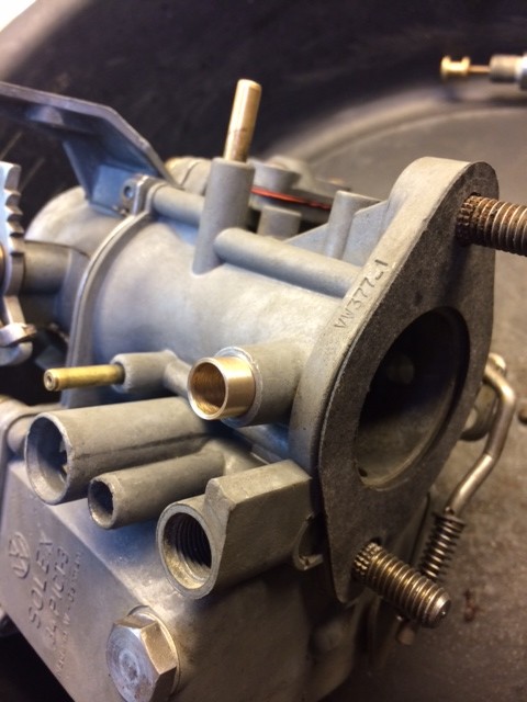

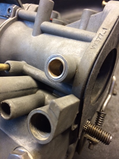

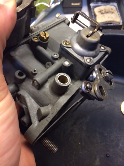

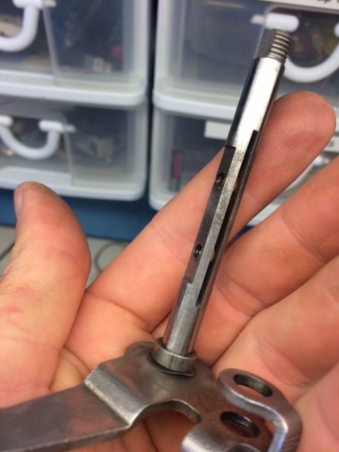

Re: 1972 Type 1

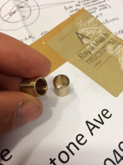

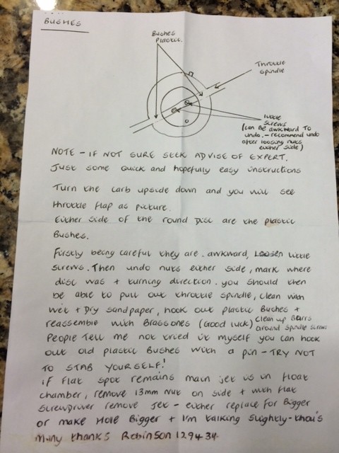

It says Royal Mail so it must be good
Comes with instructions
These are the old bushings. They are plastic
Best to clean the throttle shaft because these are a precision fit
All better
Test fit. Nice and smooth

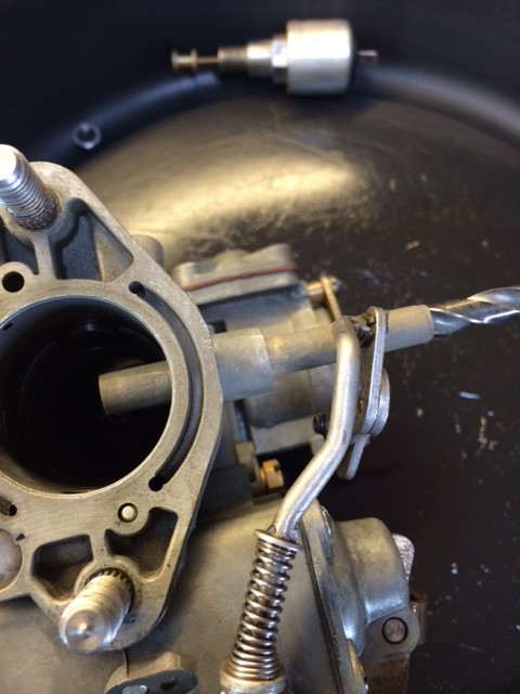

Test fit in the carburetor
Looks and feels good so pushed it. I put a tiny drop of blue locktight on the carb hole before pushing the bushings in the final bit. Not sure if that's really needed but whatever. It's not epoxy or anything so I should still be able to get these out if needed.

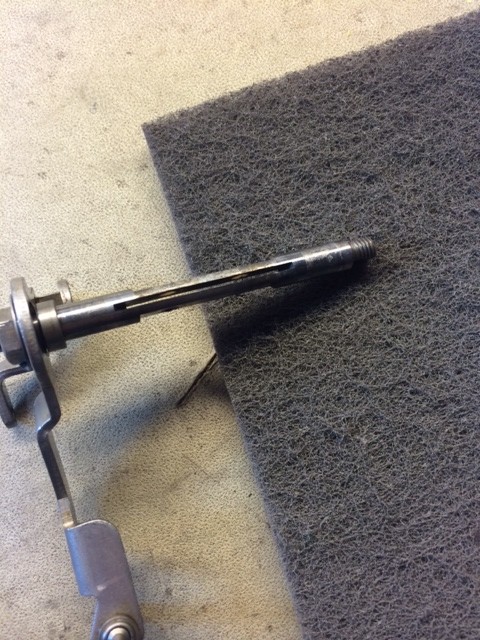

With the bushings in, the throttle shaft was a tad snug so some fine sizing with 1000 grit. Just a touch at a time until I had smooth free movement.

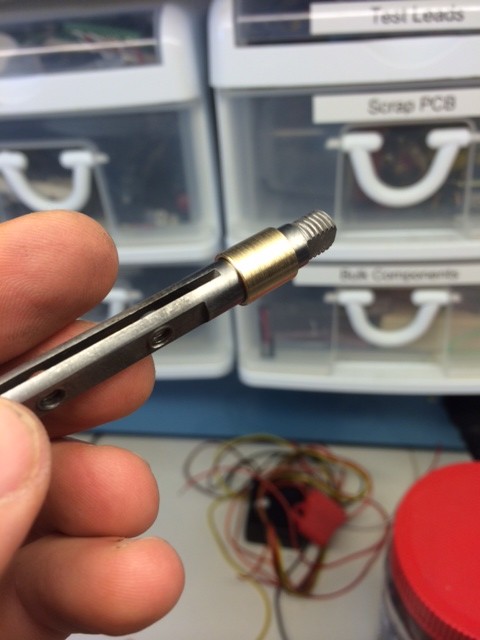

All better
