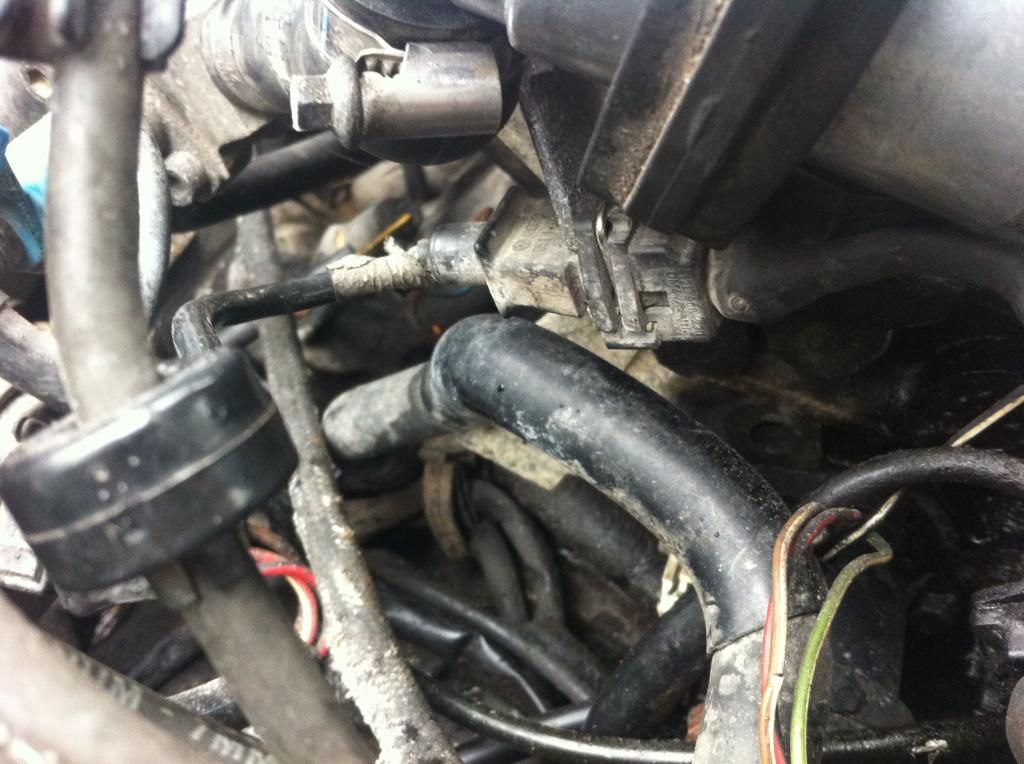

The wires going to the impulse sensor are black, green, and red.
I have four wires in question:
Black= ground obviously
White=produces 12v and spliced into the ISV
Brown=produces 8v and was grounded to the valve cover
Brown/yellow=produces 12v, was cut and grounded to the valve cover

Alright, I have solved something… Thanks for putting up with the issue and trying to help. In all the confusion I figured out that although my GLI is a 1990, the wiring is for a 1991-1992 GLI.
Their is an intermittent connection to the charcoal canister valve. I am thinking that is were my idle issue is coming from.
