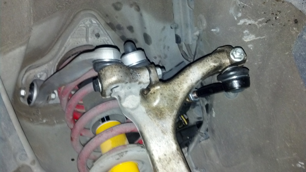

Time to upgrade the control arms, I had a front tire that was cupping really badly. I picked these up from a group buy on Audizine - the FCP Groton set with upgraded S4 upper control arms and full metal tie rods:

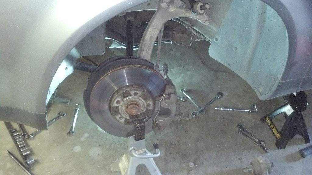

Started to pull the front suspension apart:

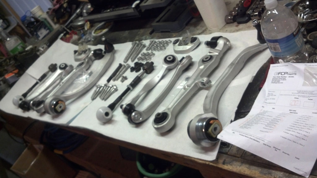

New FCP Groton arms etc. with all the hardware needed:

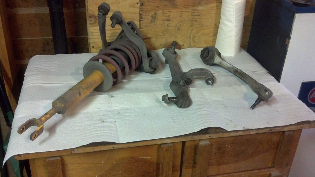

Old arms, which actually aren't that bad. My outer tie rod is the culprit I think:

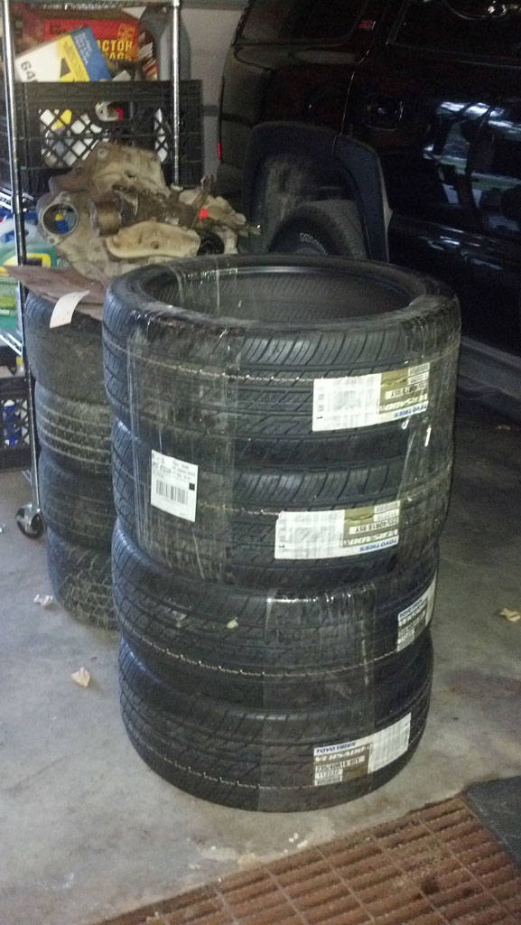

Ordered a set of Toyo Versado LX HP touring tires 235/40 R18 for the summer wheels:

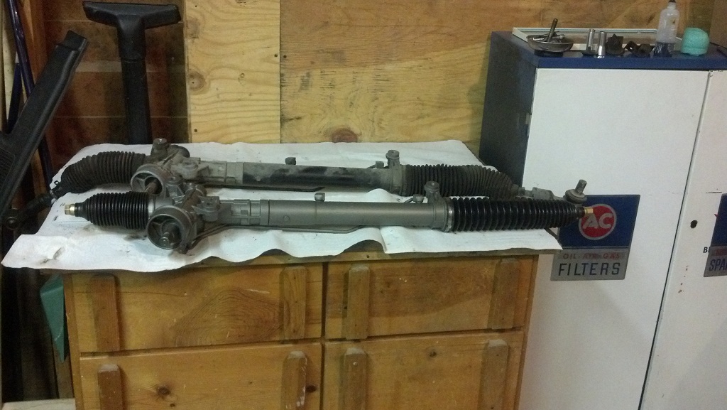

And I also ordered a reman stering rack so I can ditch my leaky rack. On the way, should be here Wednesday.

A reman rack from rackdoctor.com with a 2 year warranty. Installed, flushed the system and bled with a new can of CHF11:

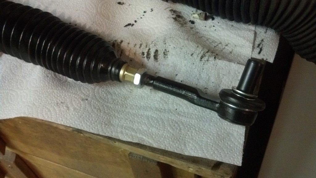

Solid metal outer tie rods installed with plenty of anti-seize and synthetic grease on the threads:

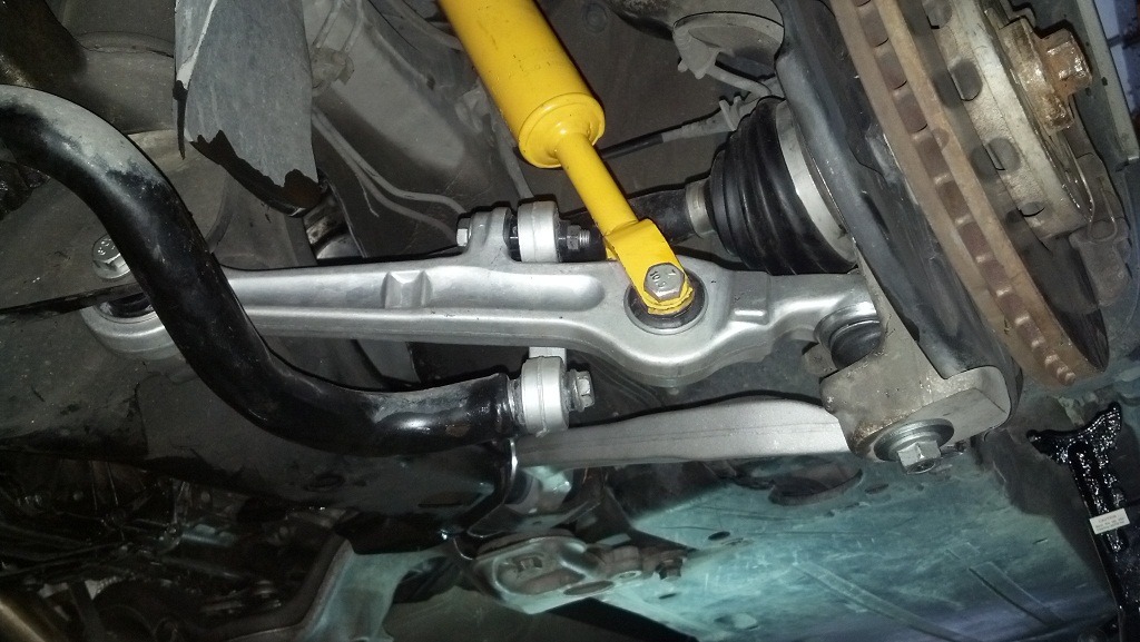

New control arms on the left side loosely bolted and ready to be torqued to spec after loading the suspension:
