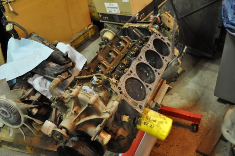

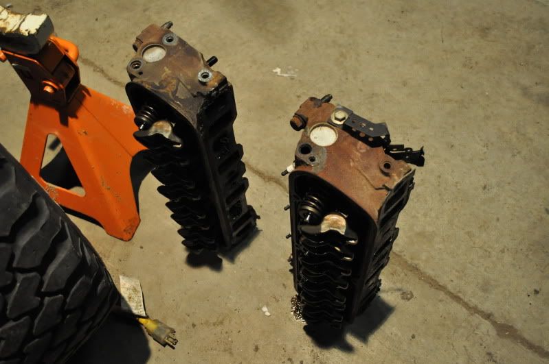

Finished pulling the heads off of both engines.
Image Image
Next the explorer heads are going to a local machine shop (M&W in Three Forks) to get cleaned and magnafluxed. If nothing is wrong with them, most likely the only thing I will do with them is a valve job and some roller rockers.

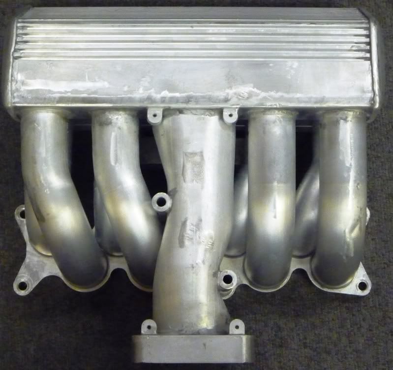

The GT40 upper intake that I acquired was previously powder coated silver. Since then it has been dinged and scratched up. So I took it in to see how much it would cost to get re-PC’d. The guy told me it would cost a couple hundred buck mainly due to how hard it was going to be to get the old PC off (getting in and around the tubing). I thought it was a pretty BS reason for the high price so I didn’t drop it off.
Started doing a little research and came across a custom bike builder who said that you can spray Permatex Gasket Remover on it and then wipe it right off with a rag. I was pretty skeptical, but never-the-less I went to Napa and picked up a can for $5.99. Would you believe it worked just like he said?!? PC is some pretty durable stuff, but this stuff instantly started making it bubble up off of the metal. And sure enough, I could pretty much wipe it off with a rag.
A couple sessions of spraying and pressure washing and I was able to get all of the PC off!

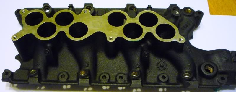

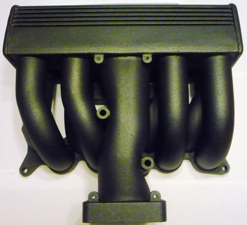

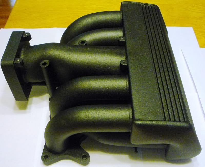

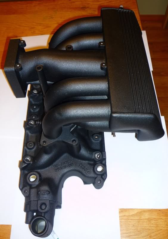

I picked up my intakes from the powder coater. They turned out really nice (pictures don’t do it justice).

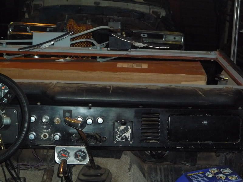

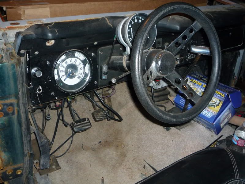

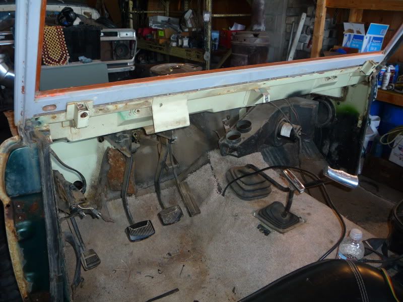

So here’s a couple pictures of my original dash. Since I will be replacing it entirely, these will show a good “before” state.
Image Image
This last Friday I removed the steering column and pulled the dash out in its entirety.
Image Image Image
Talk about a rat’s nest of wires.

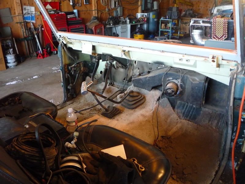

2/12
Finished getting everything stripped out of the bronco.
Image Image

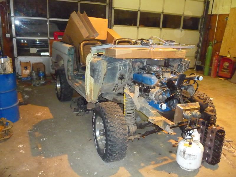

Here’s a pic of the rotisserie all finished up.
Pictures of pulling the tub. I didn’t have enough room to get the forklift next to it, so I pulled it off with a Cherry Picker and then set it on the forklift. Tested all my bracing welding during this process.
Image Image Image Image Image Image
And finally here it is on the rotisserie.
Image Image Image
