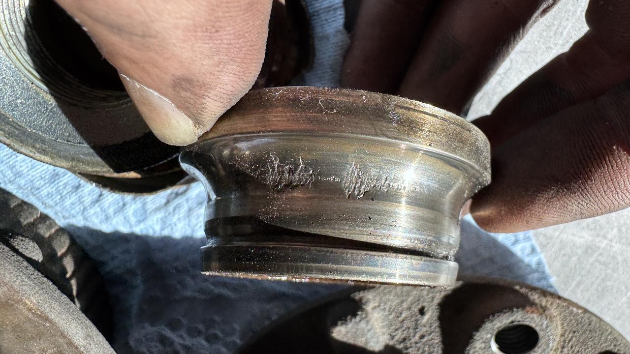

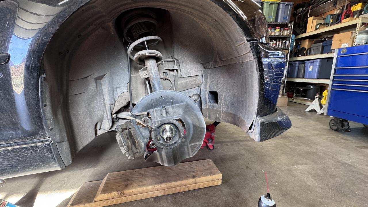

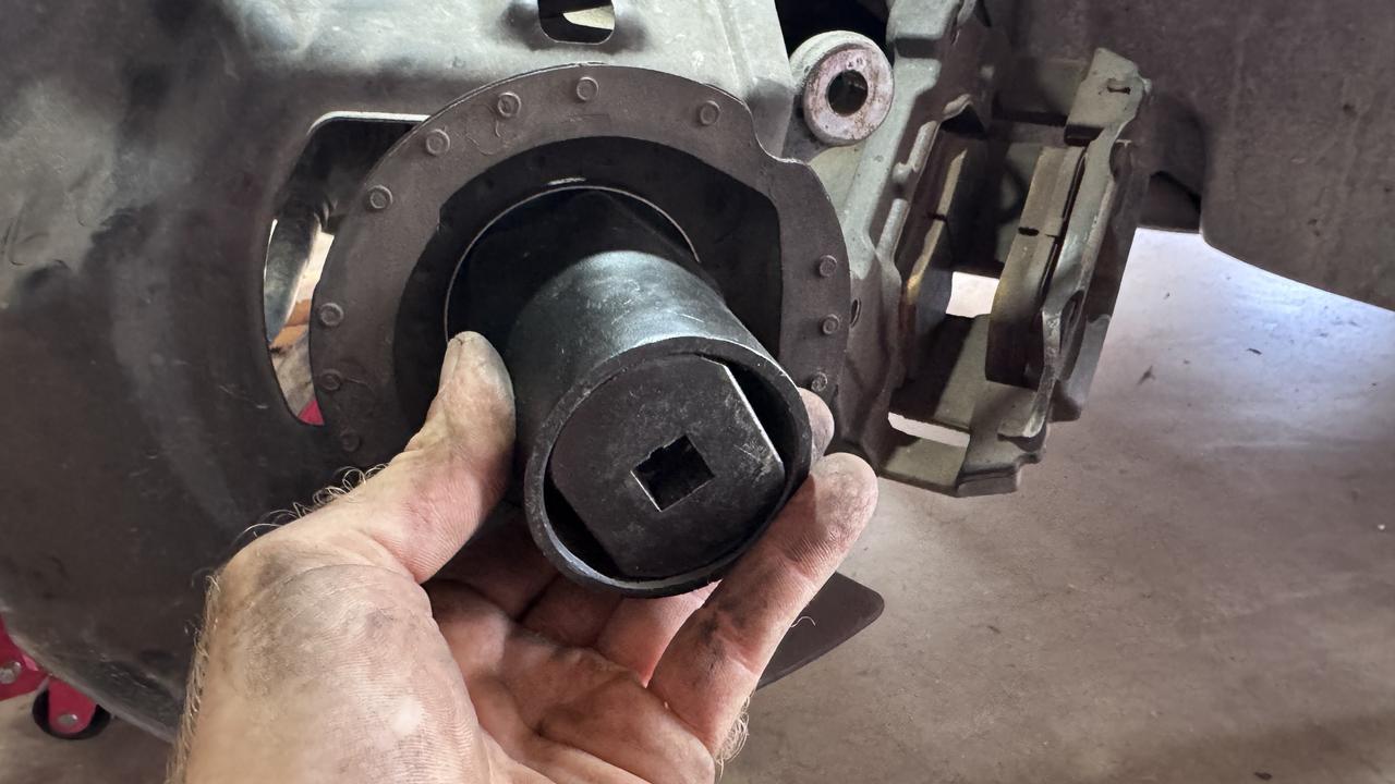

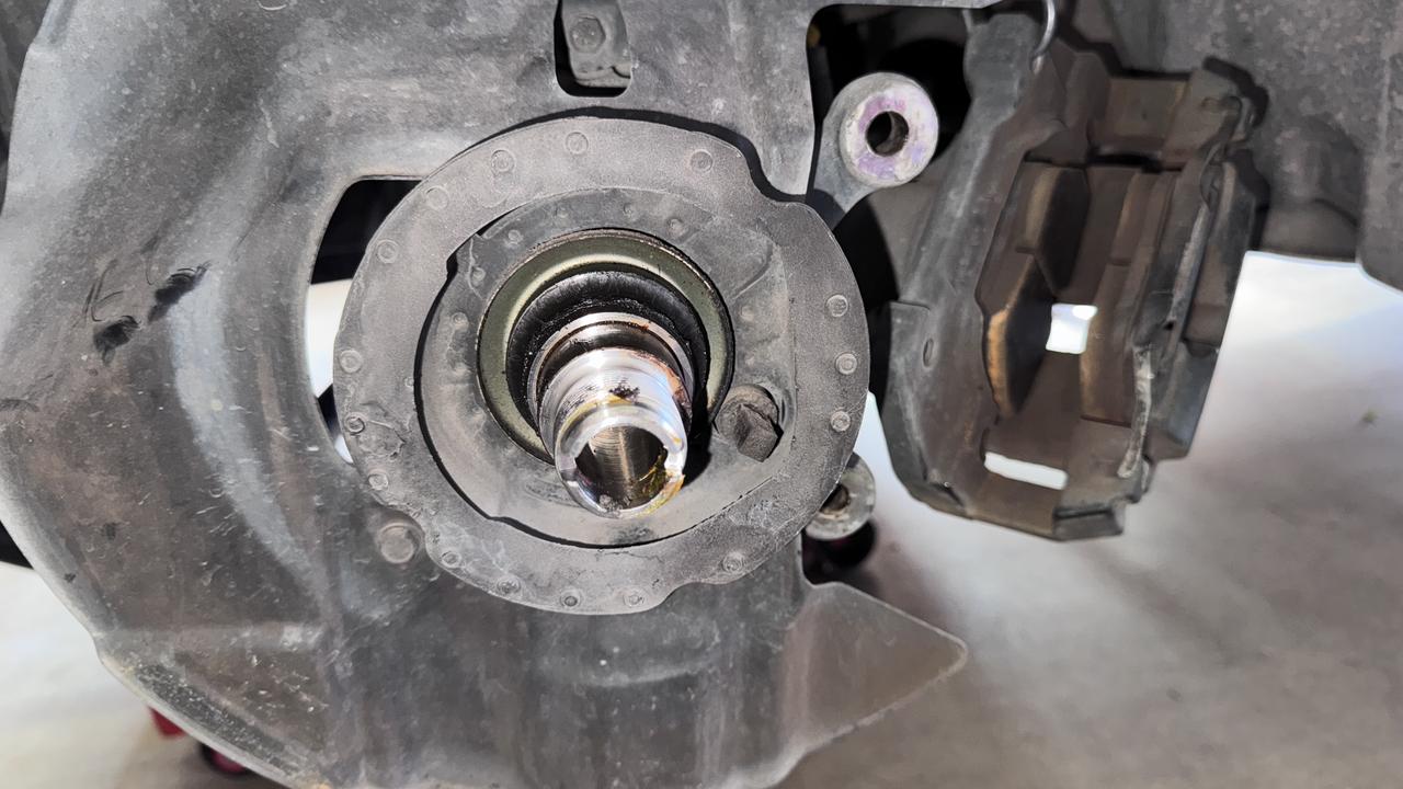

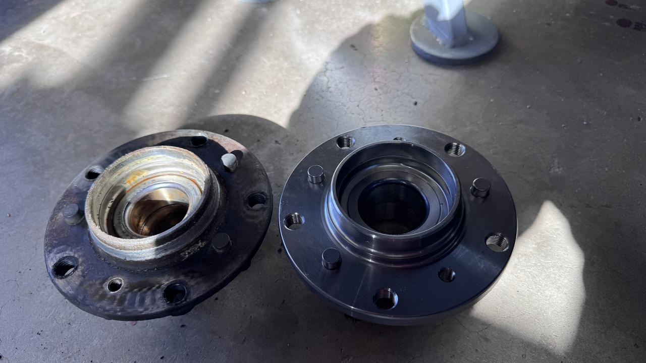

Wife has been telling me the front wheelbearing/s is making noise. Side note, I love it that she knows this sh*t. So off to replace the front wheel bearings. They're unit style that come with hubs so yeah. Wheel off, big nut off, remove hub, put new hub on, big ass torque wrench for big nut. Good to go. Really was an easy job. The $500 a pop for these.. less easy.

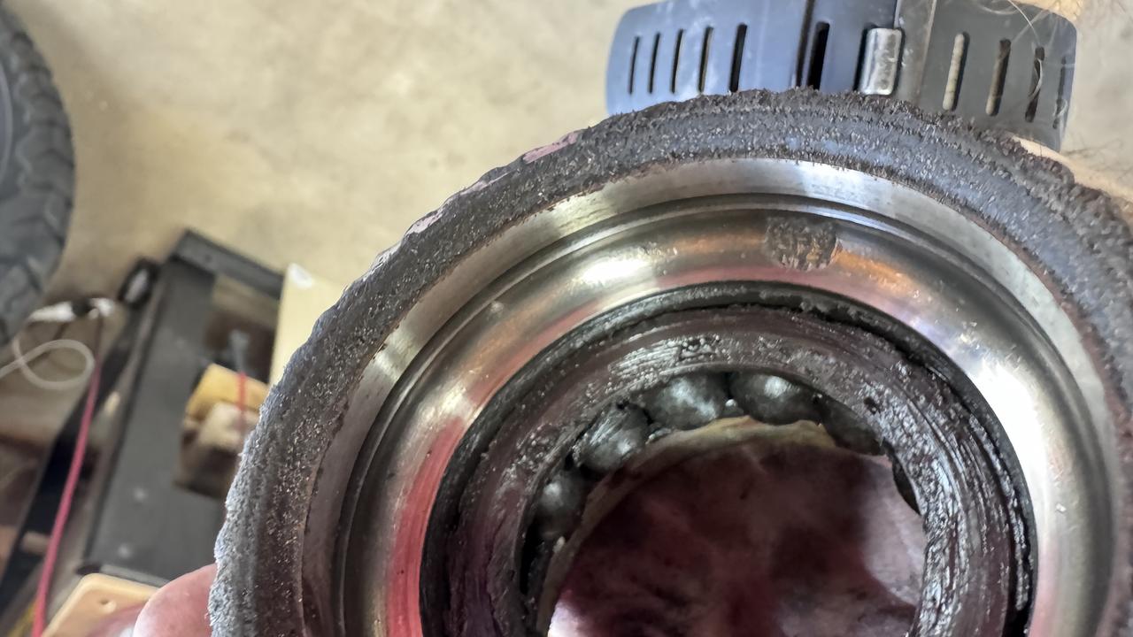

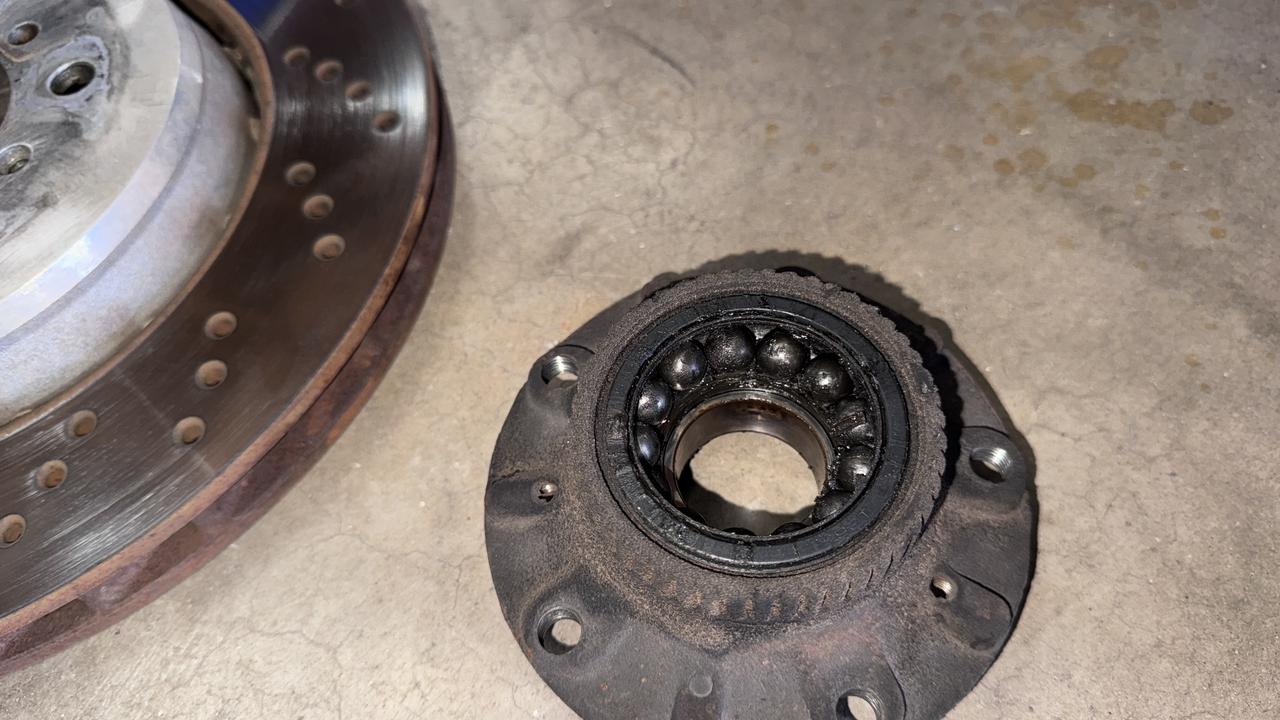

Wife was right, (I mean, was there any question) race and cup both boogered. Quieter now. :cool:
